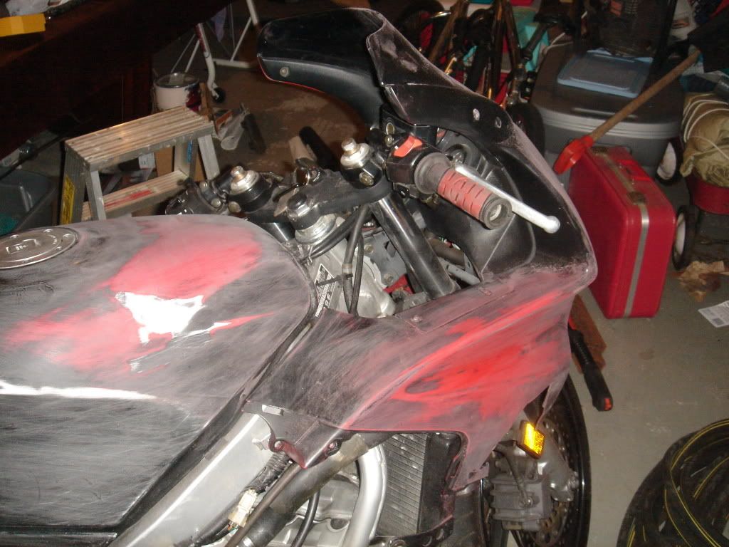

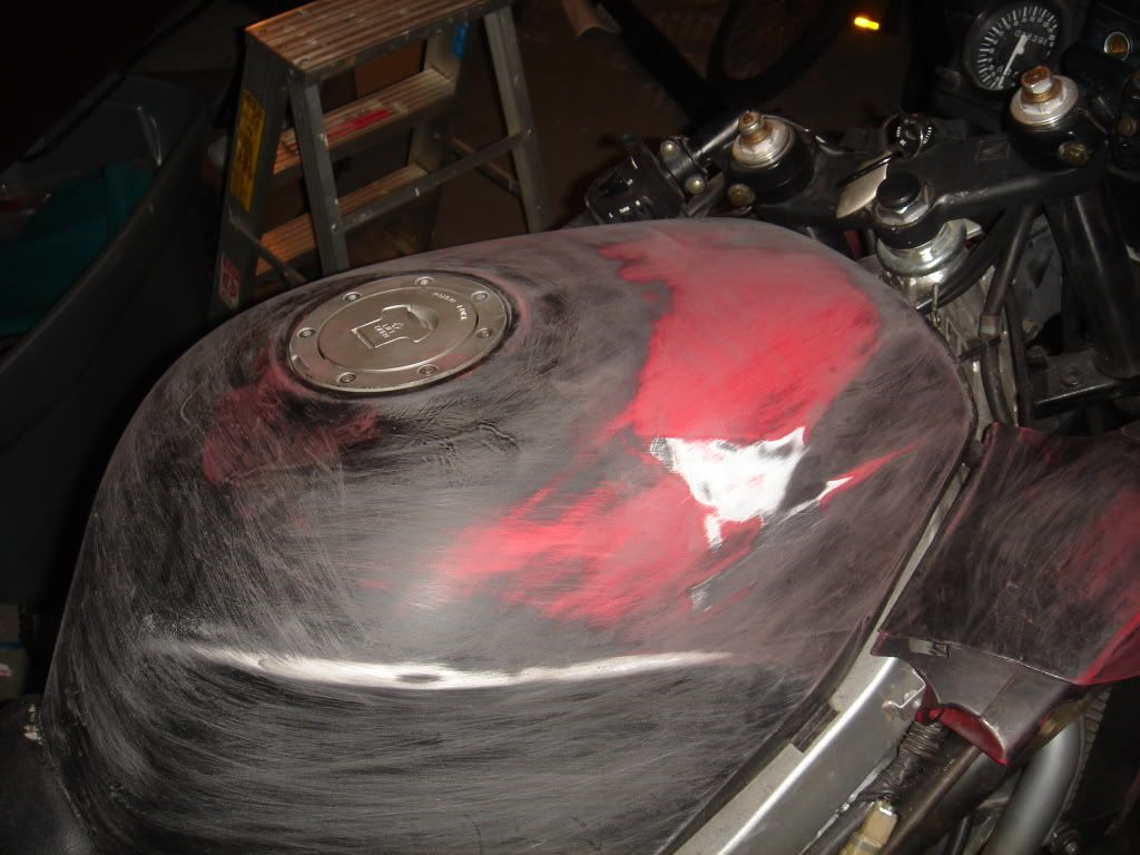

I started sanding last night for a few minutes just to see how I went.
I started with 400grit but was going pretty slow. Then I moved down to 320 and still slow. Finally I used 100grit and it worked great. It roughed up the plastic but then I hit the red with 400grit and it smoothed it out great.
Here are some pics...
I'll do some more sanding this week.

LOOKIN GOOD..MAY I SUGGEST A GOOD 2K PRIMER. ITS THICK ENOUGH TO COVER ANY SCRATCHES FROM YOUR LOWER GRIT PAPERS U MAY MISS. IF U NEED HELP ONCE U GET PAST PRIMER STAGE. ILL HELP YOU CHEAP JUST BECAUSE I HAVE A THING FOR PEOPLE WHO DESTROY BIKES WITH SPRAY CANS.
U CAN KEEP IT SIMPLE..DONT NEED AIRBRUSH ON IT.. ILL HELP U OUT JUST TELL EVERYONE ABOUT MY PLACE...
