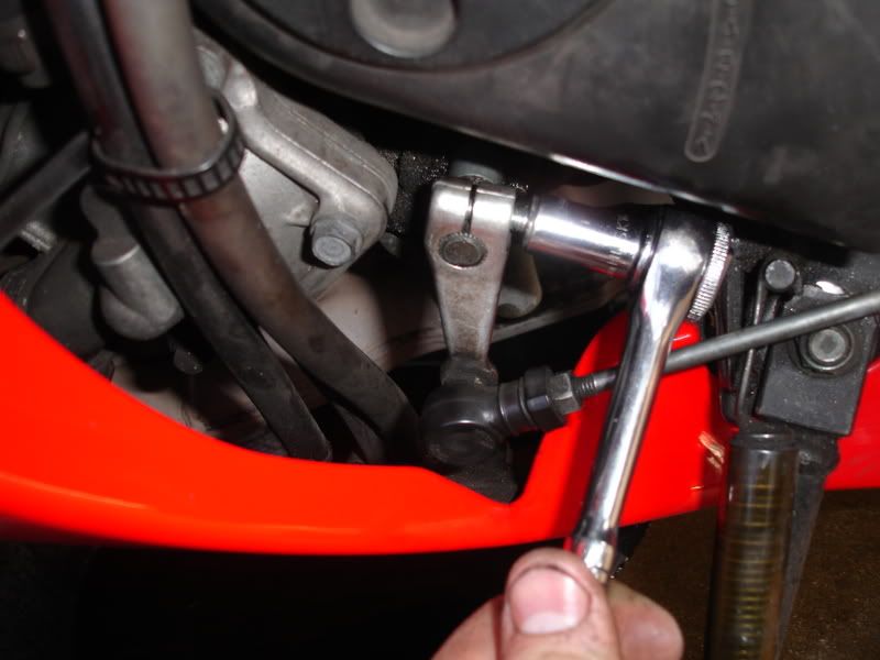

-Remove the 8mm bolt and remove the clutch cable from the release arm

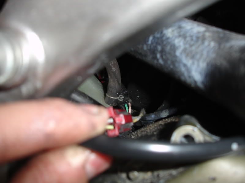

-Unplug the red 2P crankshaft position sensor connector

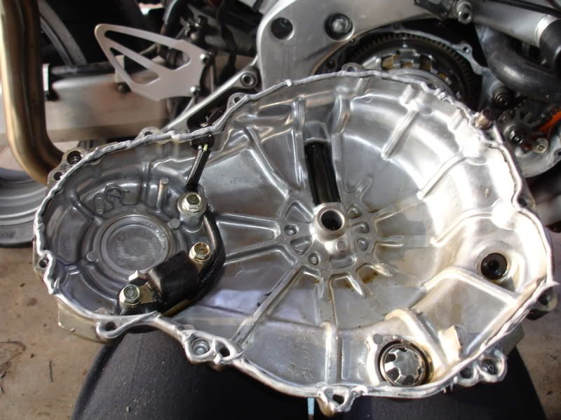

-Remove the remaining 8mm bolts from the clutch cover
-Then it may be necessary to gently tap the cover with the mallet from the backside to break the seal, then remove the clutch cover
Now here's what you'll see next

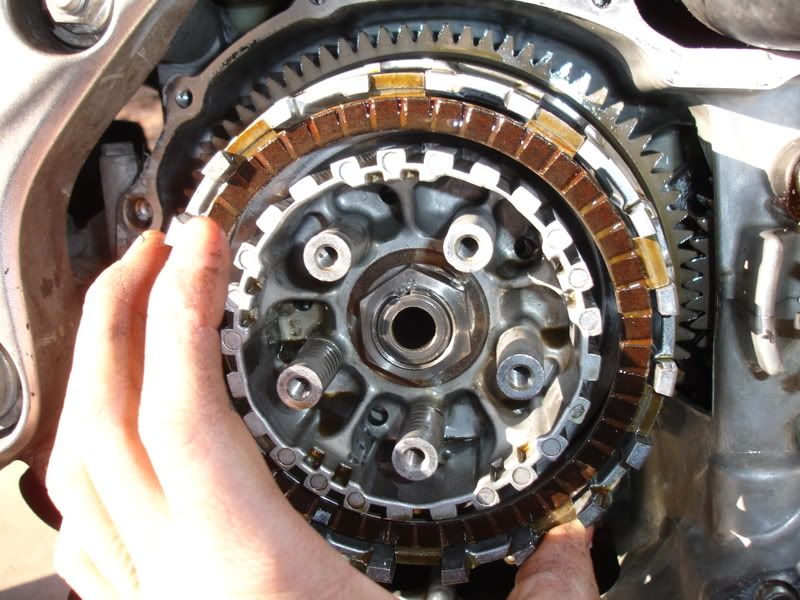

*** IMPORTANT *** Place shop rags over openings to oil pan... parts WILL drop!!!
-Remove the (5) 10mm bolts and springs from the clutch pressure plate
-Remove the pressure plate

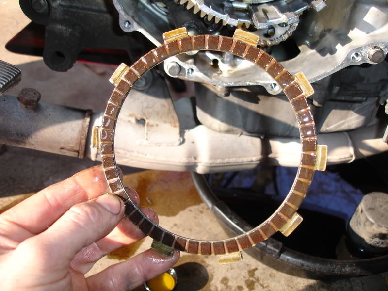

-One by one, remove each clutch friction disc and steel disc. Place in a pile (somewhere clean) face down in the order that you take them out. After the last friction disc is removed, remove the friction spring and spring seat that will be in the back of the basket. Be sure and check the pressure plate when you take it out, that the first couple discs don't stick to it. Clutch discs and steel plates have already been removed in picture. You should have: eight clutch discs (friction), seven clutch plates (steels), one spring seat, and one friction spring
-This is how your pile should look

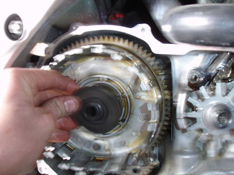

-Once the nut is off, the clutch center will slide right off. Take care not to lose the lock washer that is behind the nut, or the large washer that's on the back side of the clutch center that may come off with it when you pull it off
Clutch center

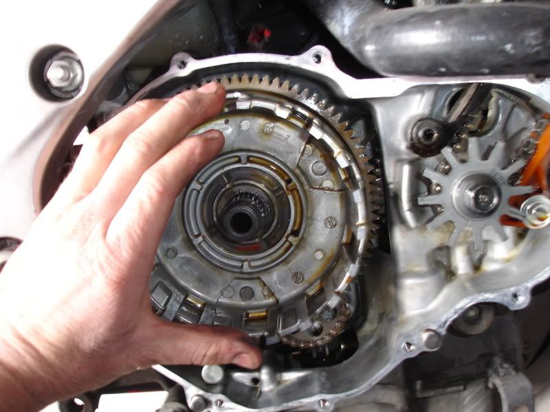

-Remove the clutch outer basket. This is kind of tricky and hard to describe... there's 2 gears on the crankshaft that mesh with the gear on the outer shell, called 'scissor gears'. They are not aligned with each other and make the clutch outer rather tight to get out and back in. You need to turn the crank until you see a small hole in the gear on the crank, and stick a screwdriver in the hole and then hold tension on the crank to make the 'scissor gears' align with each other, so that you can remove and install the clutch outer
This is what you'll now see

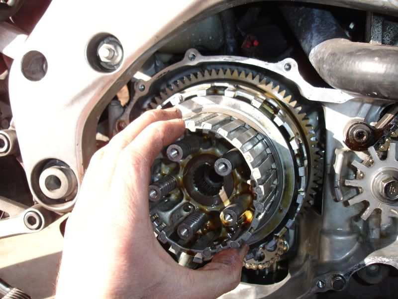

-One by one, install the clutch discs and plates from the pile in the order in which they were removed. If installing a new clutch, follow the instructions provided for which clutch plates to put where (the rear disc, the center discs, and the front disc are all different and must be placed in the correct order). Install all the clutch discs except the last one into the deep slots of the clutch outer
-Take special note... the last clutch friction disc to go in (the outer one) goes in the shallow slots on the clutch outer

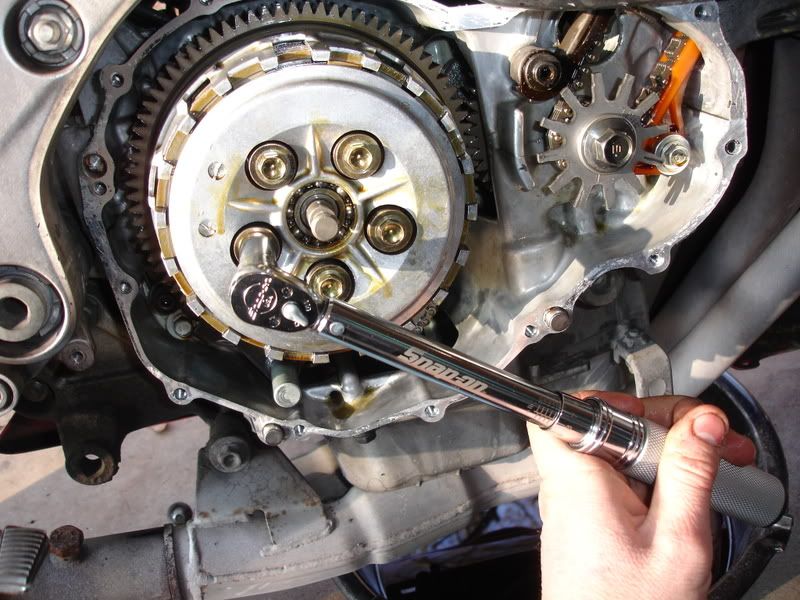

-Install the pressure plate and lifter piece
-Install the (5) springs and bolts, and snug tight in a criss cross pattern
-Continue to tighten in a criss cross pattern in 2-3 steps, and then tighten to the final torque: 108 in-lbs (9 ft-lbs)

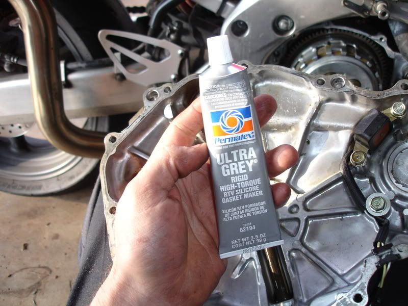

-Using brake parts cleaner and/or silicone gasket remover, remove any residual silicone from both crankcase mating surface and clutch cover mating surface. Use a plastic scraper if necessary. Clean throughly with brake parts cleaner to make sure both surfaces are free of dirt, grease, and oil
-Using Hondabond or equivelant grey oil resistant gasket sealant, apply a bead around the diameter of the clutch cover
^^^ I probably used a little too much... I always go a lil overboard with the sealant, haha
