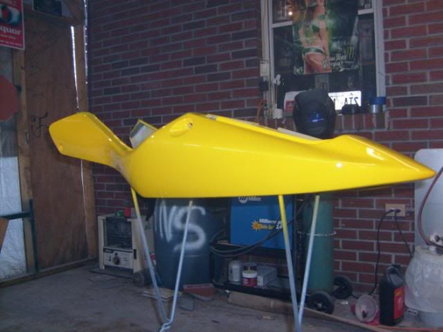

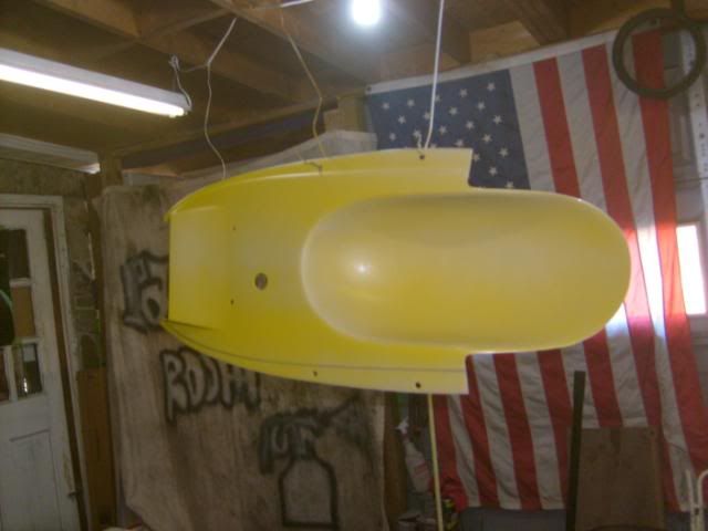

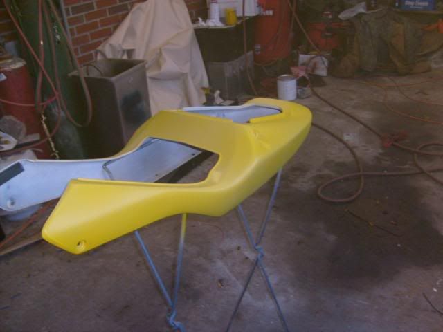

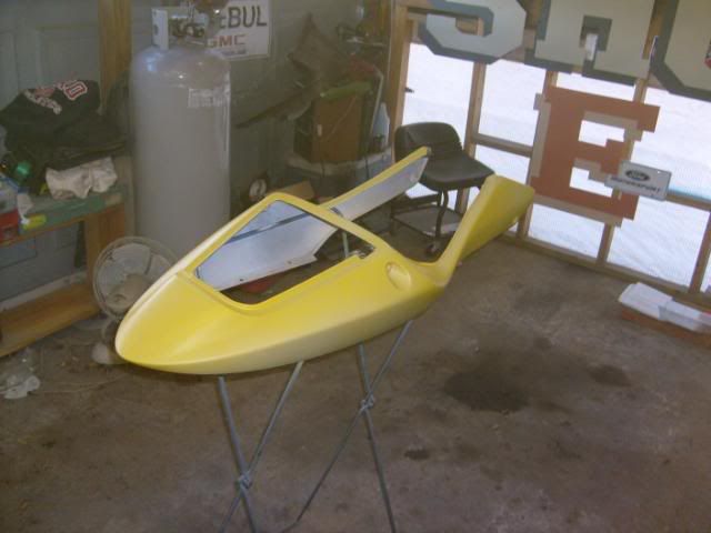

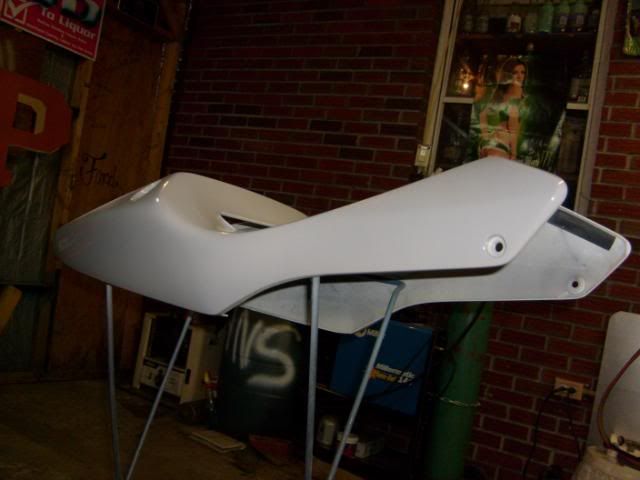

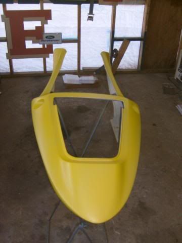

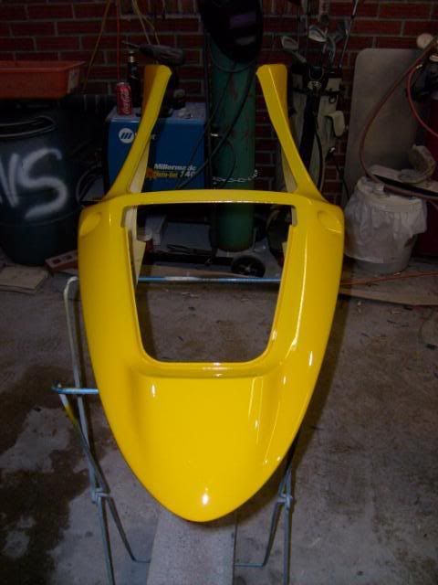

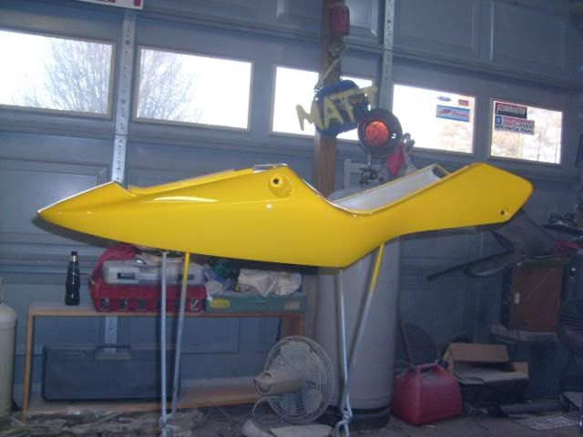

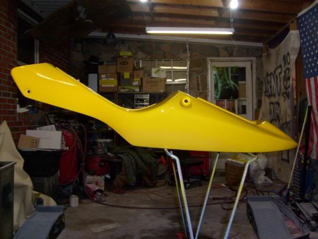

Primed:
base coat:

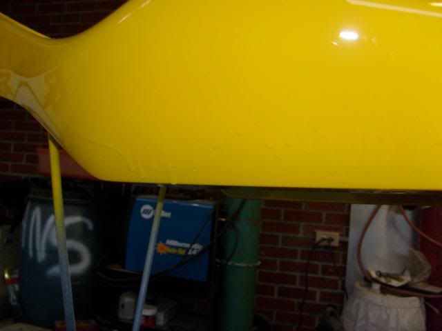

And the Clearcoat:

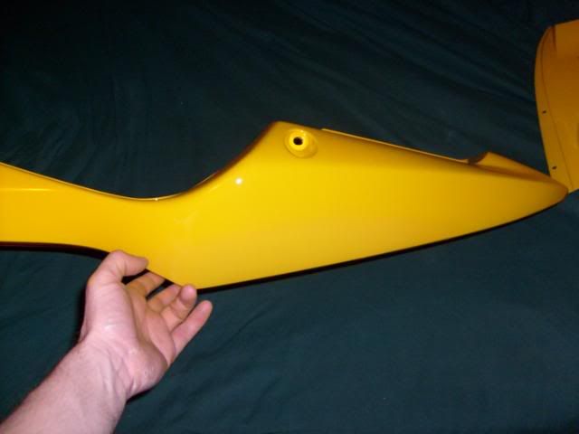

And this **** sucks...
really really REALLY SUCKS!!
So tomorrow after my math class I will be wet sanding that side and re-clearing it.
post #2 of 40 (permalink) Old 02-11-2008, 09:10 PM
got to close w/ the gun, eh.
post #3 of 40 (permalink) Old 02-11-2008, 09:12 PM Thread Starter
That or too heavy a coat. Was the last coat too dangit
post #4 of 40 (permalink) Old 02-11-2008, 09:37 PM
always happens on the last one!

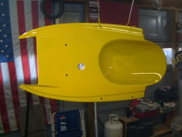

post #5 of 40 (permalink) Old 02-12-2008, 08:25 PM Thread Starter

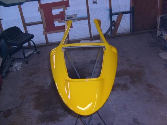

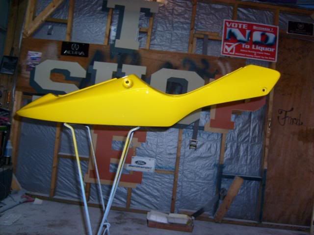

Update!
After wet sanding the runs, cutting thru the clear n base coat, goin n getting paint mixed, wet sanding the whole thing down with 800, dusting in the spots where I cut thru at, and finally reclearing it all, ITS DONE!!. I will install it tomorrow after letting it cure overnight.

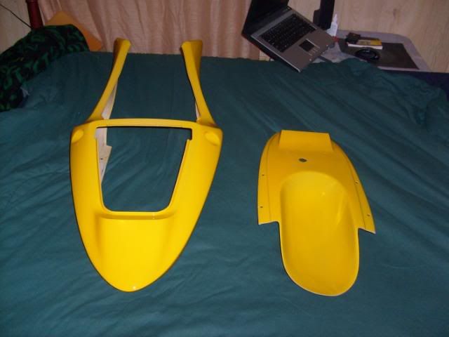

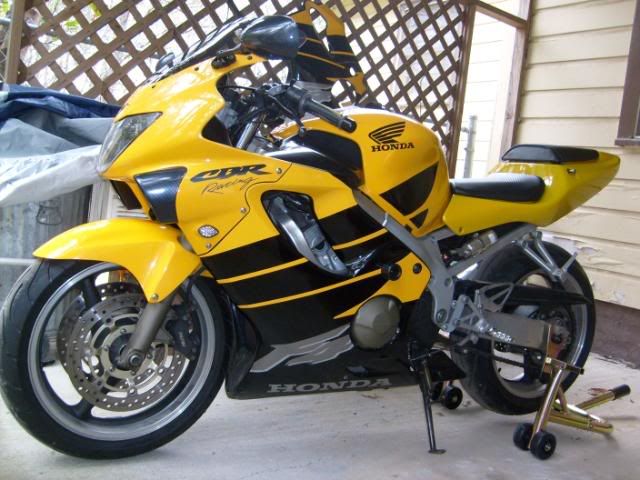

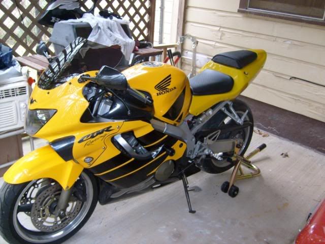

post #17 of 40 (permalink) Old 02-13-2008, 03:10 PM Thread Starter

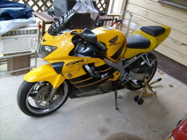

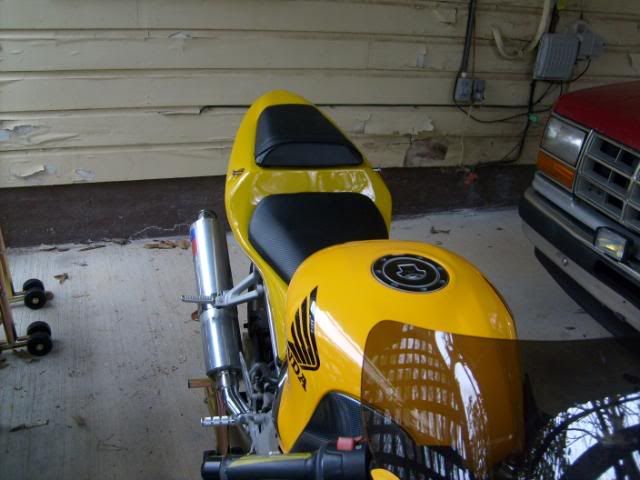

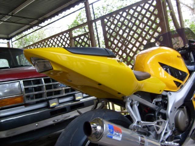

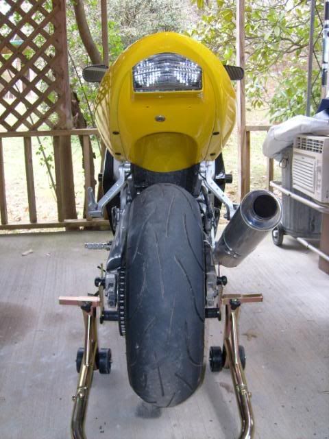

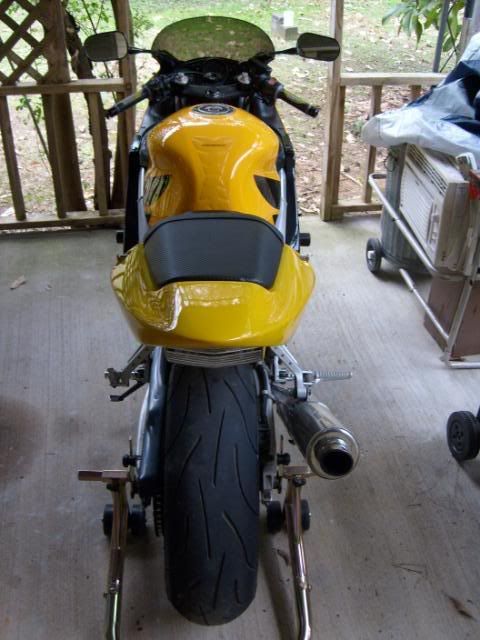

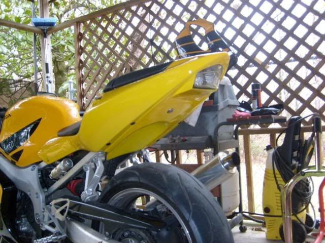

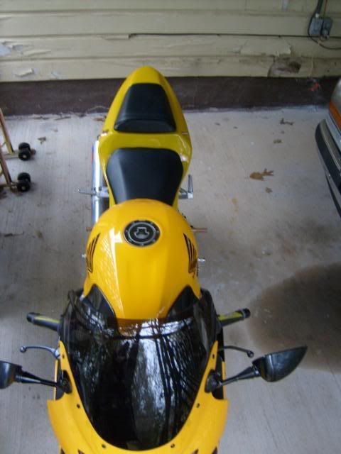

Tada
Heres the assembled results.
Its not perfect esp to me, but....
post #18 of 40 (permalink) Old 02-13-2008, 03:20 PM
It looks a little off. Either you went a little thin on the paint or it wasnt mixed right... I swear I see some primer poking through. Other than that good for a DIY project.
post #19 of 40 (permalink) Old 02-13-2008, 03:26 PM Thread Starter
I havent seen any primer showing thru, but it is lighter on the under edges of the tail itself. I think it was a combo of the two, that and I havent touched a spray gun in almost 20 years
Thanks tho
